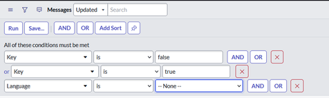

Hi @SergioRodrigues ,
Please navigate to the 'sys_ui_message.LIST' table and use this filter, select language as italian.
Check the messages column now, and update them to falso and verdadeiro

05-05-2023 05:56 AM
Hi @Karan Chhabra6,
I'd already configured these message before, as you can see, but it didn't solve my issue.
Do you have other ideia how to solve that?
