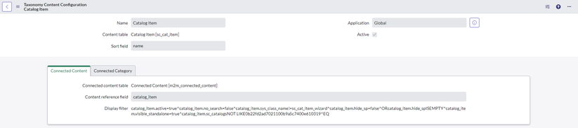

It took me some time but I could finally find the reason: For the taxonomy content configuration for Catatalog Item there is a filter:
Filter: catalog_item.active=true^catalog_item.no_search=false^catalog_item.sys_class_name!=sc_cat_item_wizard^catalog_item.hide_sp=false^ORcatalog_item.hide_spISEMPTY^catalog_item.visible_standalone=true^catalog_item.sc_catalogsNOT LIKE0b22fd2ad7021100b9a5c7400e610319^EQ
I applied it to the table [m2m_connected_content], and only the catalog item I could see under the Topic was returned. At least I had found something that made sense!

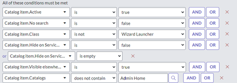

Then the next step was to find the condition that caused my catalog item not to be shown. These were all the conditions in a more readable way:
When I removed the last condition from the list I could see my catalog item. What?? I can assure you that it was not part of that Admin Home catalog, so... why was it excluded?
Because... I had not added any catalog to my Catalog Item Catalog's field. The field was empty.
It was as easy as adding it and... Voilà! Issue fixed. Now I can see my catalog item navigating to the Topic in the Employee Center.
