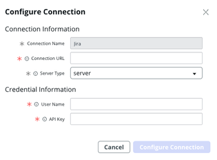

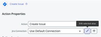

Verified my C&C Alias was in the Jira Spoke application. I tested deleting and re-entering my Credential info but it didn't seem to resolve the error. I reviewed the "Create Issue" Jira action in my flow and clicked the edit icon next to the "Jira Connection" field. I updated my Server Type to reflect the correct connection and then set my other connection details there as well and clicked, "Configure Connection". The error still displayed for a moment but after I refreshed and toggled the selections on the Project ID field the error was gone and my Project IDs were loading correctly again. I think ultimately my Server Type had not been set correctly on my server_type Connection Attribute for my Jira Connection & Credential record so I went back and updated that as well. Haven't received the error again since.
