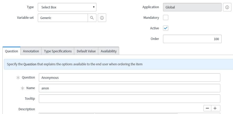

I am also using Variable Sets as there are 3 fields that appear on the top and one field at the bottom of the form. Therefore I set the first 3 as a single variable set with 100 as the Order value. this worked fine, but when I came to add the bottom value I first tried to add it as a variable which I had previously used, but found that the Edit button I needed to do this was not there:
Therefore I tried to create it as a variable set with a single field in it, which worked fine, but I tried to set it as Order value 900 to be below everything else:
However, when I saved it, it defaulted back to the value of 100.

It will be better if you could send the screen shot showing all the varaiable set and variables
OK
I have anonymised the data, but the settings are the same.
OK by looking into the settings, I can see that it is similar to what   I have in my Test instance.
Can you add Order field on the list view and see if it holds the same value   as 100
Do you mean add Order field as a Variable or a Variable Set?
