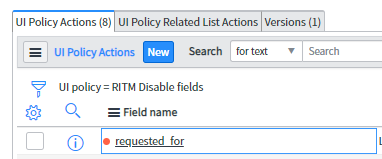

Catalog Item, UI Policy > UI Policy Actions has a red dot beside the field name. What does the red dot mean?

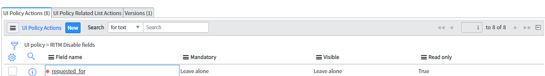

And it seems like it's unable to set the Read Only as True.
Am i missing something?
Thank you!

The Order field on UI Policies is very important to how UI Policy Actions are processed. When two UI Policies contain a UI Policy Action that acts upon the same field - even if they act upon different properties of that field (visible vs. read-only, for example) - they can potentially conflict. Conflicting UI Policy Actions will be shown in the related list on the UI Policy, with a red dot indicating the issue:
If you open the Action, you'll be presented with an error message indicating that the run order of the UI Policy Actions is unpredictable.
Please see this link for more info

Hello

Hi @Max Lin ,
UI Policies do not give consistent results, if 1) the field is on the form multiple times and/or 2) the same field from your UI Policy Action is in multiple UI Policies.  You'll know if the latter is true, because the field will have a red circle beside it within the UI Policy.  Check to see if either of those are true.
