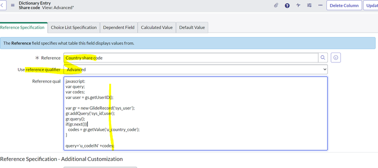

I'm thinking to add reference qualifier & create script include for share code field (reference).
Please help in creating reference qualifier and script include

You can try advanced reference qualifier on 'Share code' reference field on Task table
javascript:
var query;
var codes;
var user = gs.getUserID(); //get logged in User
/*Glide record on user table*/
var gr = new GlideRecord('sys_user');
gr.addQuery('sys_id',user);
gr.query();
if(gr.next()){
codes = gr.getValue('u_country_code');
query='u_codeIN' +codes;
/*Here,
u_code = Code name field present on custom 'Country share code' table may be different for you*/
**You can use this script script include function & call that in reference qualifier...

01-29-2024 04:10 AM
Hi Vishal,
the above should be in script include or Reference qualifier (Advanced). I believe it is script include but I can see you've written it on Ref qualifier.
Could you please confirm
01-29-2024 04:36 AM
Hi @Dee S
Both will work....
You can write script in reference qualifier also......this will work....
But its general practice to write code in script include & then call that script include in reference qualifier
