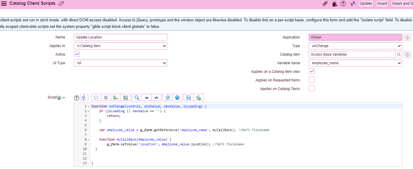

In the below example I am trying to create a form that collects basic data about a selected user. I am able to display the data that is held in the user table, however, I also want to display the information in another table that is referenced so almost a nested result.
When I select a user there is a value in the user record called location and i can display that without any issue if I update the user the location will also update based on the value of the different user.
I need some help with the next field. Each location has a value for "Division" and I want to display that when the location updates.
My Form
I am updating the location using a catalog Client Script and this is working for the location field just fine
How do I get the Division to display the value held in the location table reference above?

You can only dot-walk to 1-level using getReference(). If you want to go further then you would need to use GlideAjax.

Hello Phil,
Please use the below scripts and replace the location and division field/variable name as per your instance:
Client Script:
        g_form.clearValue('location'); // Clear value if newValue == ""
		g_form.clearValue('division');
        return;
    if (newValue) {
        var getAvaCnt = new GlideAjax('UserLocationDetails');
        getAvaCnt.addParam('sysparm_name', 'getLocationData');
        getAvaCnt.addParam('sysparm_employee', newValue);
        getAvaCnt.getXMLAnswer(parseLocationResponse);
    } else {
function parseLocationResponse(response) {
    var answer = response.split(",");
	g_form.setValue('location', answer[0]);
    g_form.setValue('division', answer[1]);
Script Include:
var UserLocationDetails = Class.create();
UserLocationDetails.prototype = Object.extendsObject(AbstractAjaxProcessor, {
	validateRequestedQuantity: function() {
        var dataArray = [];
        var userGuid = this.getParameter('sysparm_employee');
        var userGR = new GlideRecord('userGuid');
        if (userGR.get(MaterielType)) {
             dataArray.push(userGR.getValue('location'));
			 dataArray.push(userGR.location.division.toString());
        return dataArray.join(",");
    type: 'UserLocationDetails'
Please mark my respsone as helpful/correct, if it answer your question.
