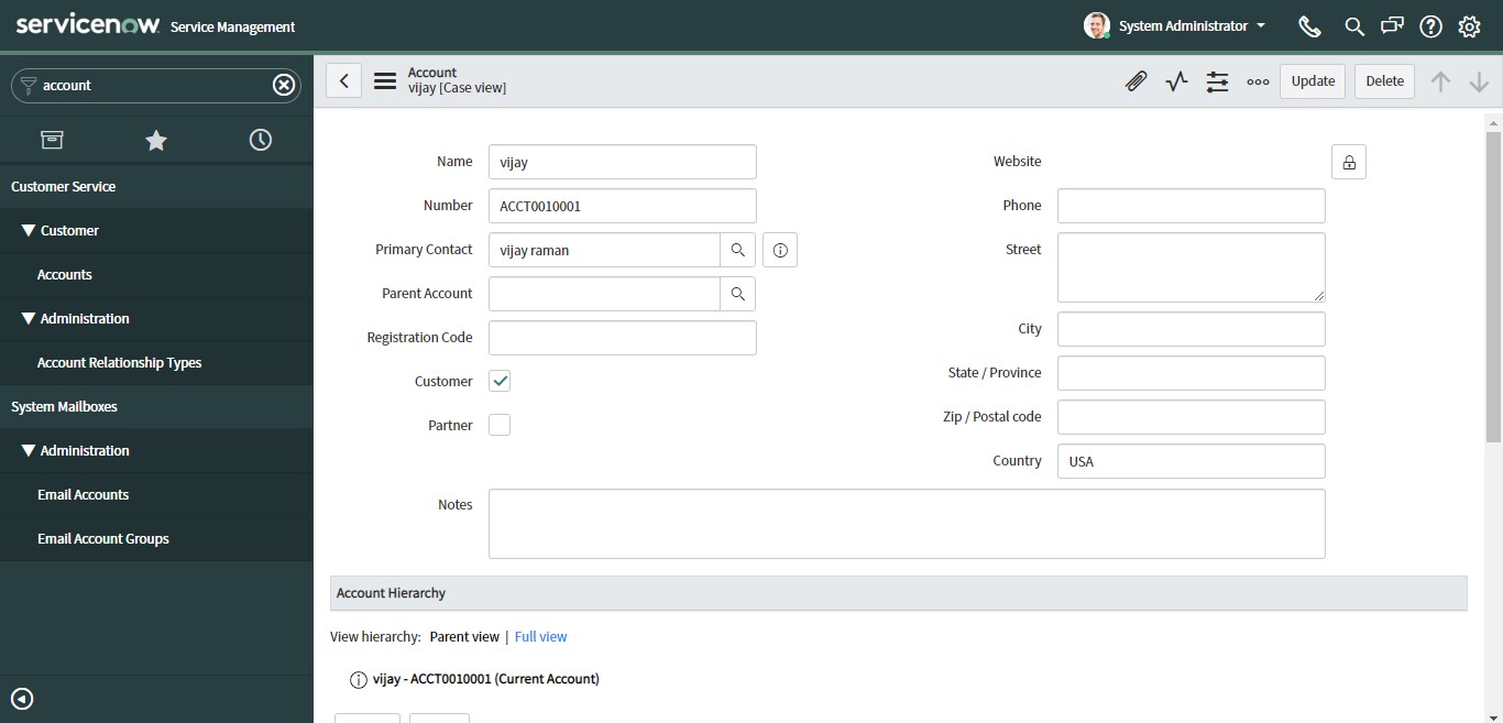

This is my account page,
WWhen I execute https://dev71739.service-now.com/api/now/table/customer_account?number=ACCT0010001, it throw response like below
We need the account team members (related data) details in the response. How can we make a URL to get the related tasks details also when we call the table API? Please suggest me
04-07-2020 05:13 AM
If you only want one URL and you want data for both parent ticket and task to it then go for scripted rest api.
If you really dont have that requirement then use two seperate API one for parent and one for task.
