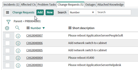

In the problem record, when you go to the "Change Request" tab and add there change requests, you are basically setting the field "Parent" in the change request to have a reference to your problem record. Example here:
The 5 change requests have the field "Parent" set to "PRB0040001".
