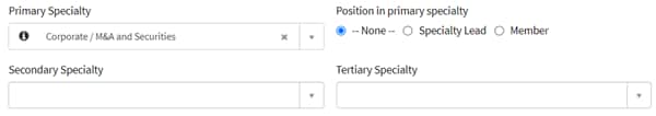

I have a form with 3 reference fields.  The idea is to not have the user select the same option in any of the 3 fields:find_real_file.png
So if the user selects "Financial Services" for Primary, they should not be allowed to select the same for Secondary or Tertiary.  Therefore I would like to remove those options from these reference fields.

It does nothing... the option still exists...  Not sure what I am doing wrong.  Please help.

Removing options will not work on a reference field. It's only valid if it were a choice field.
In this case you would need to create an advanced reference qualifier, and a script include on all three fields, and use the input value to determine which results should be displayed.

If they are referencing to some table, you would need to create a advanced reference qualifier. Since g_form.removeOption will not work, as it only works if you have choices.
