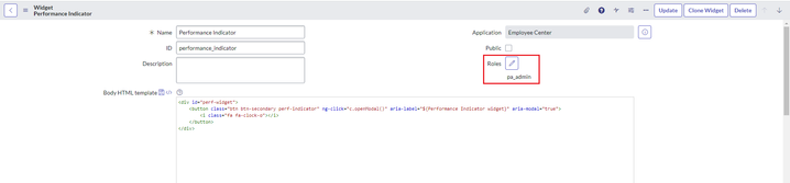

I was facing the same issue for a client. It seems it is not possible to fully deactivate it.
An alternative could be to restrict it to a particular role, for example pa_admin, which would make sense.
You can do that from the widget record itself (Service Portal > widgets : Performance Indicator) see screenshot below.
Hope this will help you already (and please mark as helpful if it did 🙂 ) ! Let me know if you're facing any issue with this.
Thank you !
