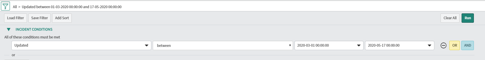

I would suggest that you use ServiceNows query builder to make you initial queries and then build them in your C# app
These are examples for different inputs for ServiceNow to filter in either periods or "today" as examples
query["sysparm_query"] = "sys_updated_onBETWEENjavascript:gs.dateGenerate('2020-03-01','00:00:00')@javascript:gs.dateGenerate('2020-05-17','00:00:00')";
query["sysparm_query"] = "sys_updated_on>=javascript:gs.beginningOfToday()";
And then:
Below is a C# sample that should return the correct incidents from a given period or date of these examples
And then:
