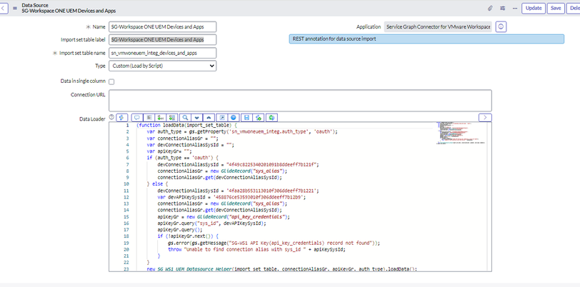

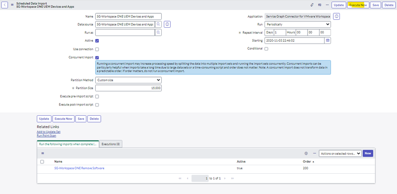

We have implemented 'SG-Workspace ONE UEM Devices and Apps' integration using Service Graph
connectors and it populates the data in target table named 'cmdb_ci_computer' everytime when Scheduled Data Import
(below) executed
Data Source -
Script:
(function loadData(import_set_table) {
    var auth_type = gs.getProperty('sn_vmwoneuem_integ.auth_type', 'oauth');
    var connectionAliasGr = "";
    var devConnectionAliasSysId = "";
	var apiKeyGr= "";
    if (auth_type == 'oauth') {
        devConnectionAliasSysId = "4f49c8225340201091b8ddeeff7b121f";
        connectionAliasGr = new GlideRecord("sys_alias");
        connectionAliasGr.get(devConnectionAliasSysId);
    } else {
        devConnectionAliasSysId = '4faa28b553113010f306ddeeff7b1221';
        var devAPIKeySysId = '458876ce53593010f306ddeeff7b12b9';
		apiKeyGr = new GlideRecord("api_key_credentials");
        apiKeyGr.query("sys_id", devAPIKeySysId);
        apiKeyGr.query();
        if (!apiKeyGr.next()) {
            gs.error(gs.getMessage("SG-WS1 API Key(api_key_credentials) record not found"));
            throw "Unable to find connection alias with sys_id " + apiKeySysId;
    new SG_WS1_UEM_Datasource_Helper(import_set_table, connectionAliasGr, apiKeyGr, auth_type).loadData();
})(import_set_table);

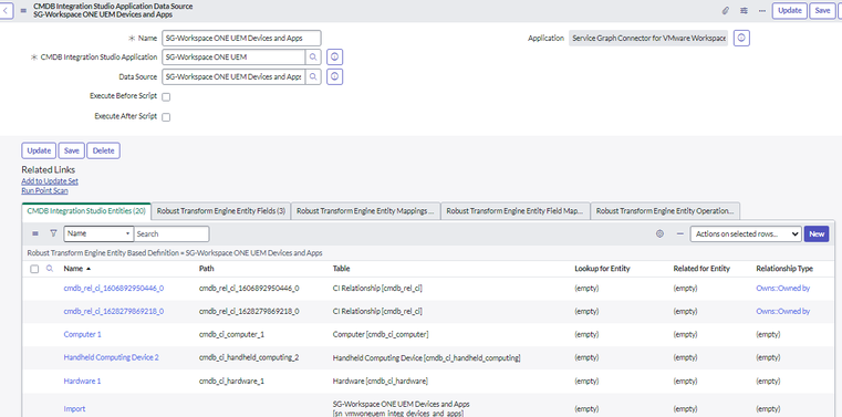

In 'SG-Workspace ONE UEM Devices and Apps' Plugin, Robust Transform map is used, In normal transform map we can write onBefore script to achieve this.
Here I know that need to modify 'CMDB Integration Studio Application Data Source'
by marking check to 'Execute before script' (below)
Script:
  * Script executed for a given batch before calling the Identification and Reconciliation Engine (IRE)
  * The following variables are available to the script:
  *    'input' - the array where each element of the input array is an object. Each object contains a status, reason, and payload.
  *    'runId' - the current import set run id.
  * Example:
 // (function(input, runId) {
 //     for (var i = 0; i < input.length; i++) {
 //         // Skip all payloads which have a computer starting with name as 'TEST-'
 //         if (!isComputerNameValid(input[i].payload)) {
 //             input[i].status = 'SKIPPED';
 //             input[i].reason = 'Skipping IRE processing of this payload.';
 //         } else {
 //             // Add new value to items
 //             input[i].payload.items[0].values.short_description = 'Adding missing description';
 //             // Add a new relationship by passing a JSON object (Use unshift() to add a relationship at the beginning)
 //             // Similarly, any relation can be removed by using the pop() or shift() methods
 //             var relation = {
 //                 'parent': 0,
 //                 'child': 1,
 //                 'type': 'Runs on::Runs'
 //             input[i].payload.relations.push(relation);
 //             // Update an existing reference item by passing a JSON object.
 //             // Similarly, the entire reference items array can also be updated e.g. input[i].payload.referenceItems = {...}
 //             input[i].payload.referenceItems[0] = {
 //                 'referenceField': 'software',
 //                 'referencedBy': 'internal_id2',
 //                 'referenced': 'internal_id1'
 // })(input, runId);
 // function isComputerNameValid(payload) {
 //     for (var i = 0; i < payload.items.length; i++)
 //         if (payload.items[i].className == 'cmdb_ci_computer' && payload.items[i].values.name.startsWith('TEST-'))
 //             return false;
 //     return true;
  * The following properties/functions are available for all parameters of type 'Array' inside the IRE payload e.g. items, relations, referenceItems, lookup and related:
  * length - Returns the number of elements in an array
  * push() - Add an item to the end of an array
  * pop() - Remove an item from the end of an array
  * shift() - Remove an item from the beginning of an array
  * unshift() - Add an item to the beginning of an array
  * Important points:
  * 1) The before script is executed once per batch and not per payload. The input array elements contain all the payloads for a given batch.
  * 2) Each element in the array has only 3 fields i.e. status, reason, and payload. Adding additional fields to the array elements might result in unexpected errors.
  * 3) The 'status' can be set to 'SKIPPED' in order to skip a payload in this batch from further processing. Setting 'status' to any other value will be ignored by the RTE processor.
  * 4) Optionally, a 'reason' can be set for skipping the payload. This will be the message on the import set run for this particular row.
  * 5) To match the batch size after script execution, only the length property is available for input array e.g. input.length
  * 6) Using any of the above functions e.g. push(), pop(), shift() and unshift() on input array directly will result in unexpected errors.
  * Below is an example of an IRE input payload. There can be more fields/parameters depending on each use case. Refer to the ServiceNow Product Documentation for more examples on the IRE payload.
  *  'items': [
  *      'className': 'cmdb_ci_computer',
  *      'values': {
  *        'name': 'Macbook Pro 15',
  *        'os_version': '5.1.2600',
  *        'ram': '2048',
  *        'disk_space': '1024'
     // Add your code here
 })(input, runId);
