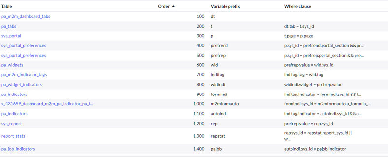

Hi @Admin7267 ,
You can run a report towards the table sys_report to get a report of all reports created and by who. If you need to see it according to which dashboards the single reports belong to, it will get a little more complexed.
Basic you can create a database view just like below:
You don't need it all, as some of the tables refer to performance analytics etc.
Best regards
