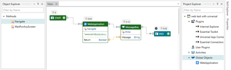

The problem I'm facing is that despite having installed the Chrome Extension / Edge Extension on the browsers and the application is finding the pages, so i could devolp it
when I press Run it displays the following message in the first action wich is Navigate:

Hi
Hope you've already fixed this but if not I also couldn't use the Chronium option (exact same error) but as it complained about the universal connector when I installed Chronium I thought I'd try using the stuff that came default and that worked fine.
Try that and see if it works?
