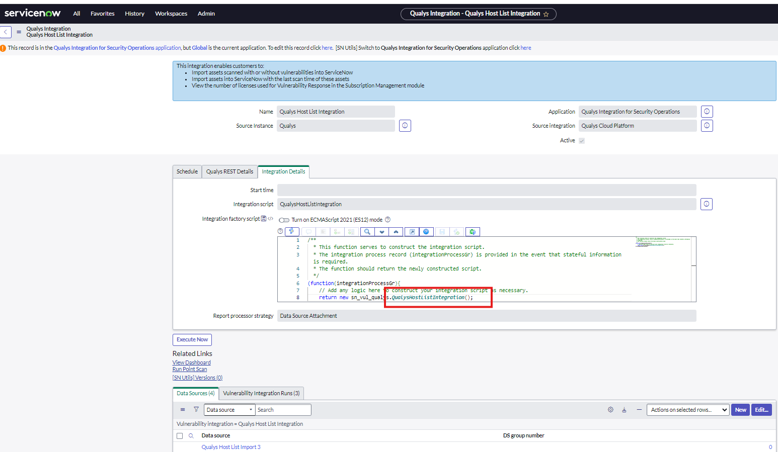

kalyanaP
I am trying to debug the Script Include that is highlighted below. When I execute this job, I want to debug the script includes with the break points.
