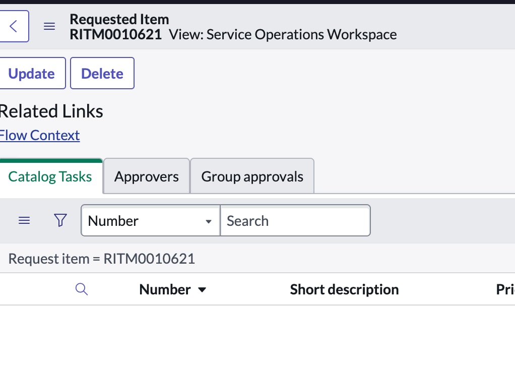

When I submit a request, no task is being triggered.
Any thoughts?
Looks like we're getting closer. Previously the test was failing
