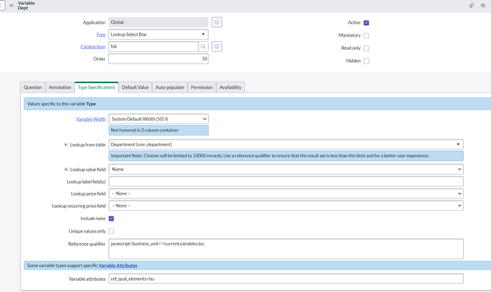

Hi @Nipan1 ,
There is not need for Client Script & Script Include.
You can add reference qualifier in lookup select box variable.
Don't forget to add variable attributes.
Reference Qualifier : javascript:'business_unit='+current.variables.YourBusinessUnitVariableName;
Variable attributes: ref_qual_elements=YourBusinessUnitVariableName

Hi @Community Alums,
Thanks for your response! The solution you provided works for me.
