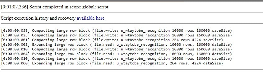

Thank you very much for the response. I checked all the fields and this script looks correct but when I run it as a background i get the following error. It is looking to update about 20,000 records. Thoughts? find_real_file.png
