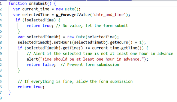

I have created a date and time field and the selected date and time should be one-hour in advance.
So, I have created a on Submit client script and it's not working.

If you still want to use onSubmit then update your script as this
function onSubmit() {
var mydate = g_form.getValue('date_and_time');
var minutes = 60;
var dt = new Date(getDateFromFormat(mydate, g_user_date_time_format)).getTime() + minutes * 60000; // add 60mins to date and then compare
var nowTime = new Date().getTime();
if (dt < nowTime) {
alert('date should be after 60 from now');
return false;
