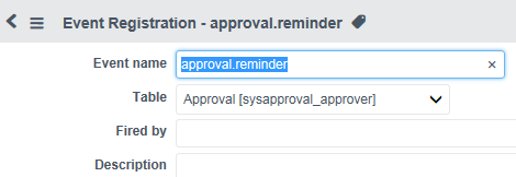

- Created new event:
- Created notification to send when even is fired.
- Created a schedule o run periodically every 3 days with the following script:

This is how the schedule looks:
