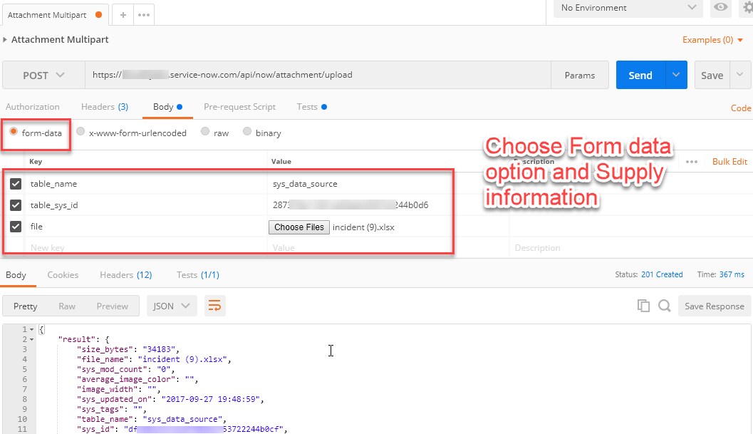

Thanks, I am able to send file via REST API Explorer. But unable to send attachment via Postman to Service now,   can you provide the steps for Postman to service now.
I tried like below
URL: https://XXXX.service-now.com/api/now/attachment/upload?table_sys_id=XXXXXXXX057825740cf96190f&table_...
Method: Post
form-data :
file: <choose a file from upload button>
Header:
Content-type: multipart/form-data
Note: I used basic authentication

I was able to send file using postman. Please find screenshot below:
Note from stackoverflow post:
Beware, when testing your webservice using chrome postman, you need to check the form data option(radio button) and File menu from the dropdown box to send attachment. Explicit provision of content-type as multipart/form-data throws an error. Because boundary is missing as it overrides the curl request of post man to server with content-type by appending the boundary which works fine.
Link: html - What is the boundary in multipart/form-data? - Stack Overflow
https://stackoverflow.com/questions/39280438/fetch-missing-boundary-in-multipart-form-data-post
