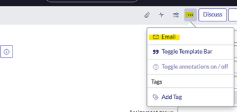

Hi @rcarter ,
Are you not using email client based email, where you can set all parameters. It's OOTB, you just need to enable on table level.
Once it's enable then you can access , default it will open with pre-populated subject line with incident number & Short description. You can customize this via email client template.
Hope we are on same page of your requirement, as UI Action based email need to trigger from some record ( like incident ) and Email Client is already there. Let me know if it works or you have some other thought.

Thanks for the info Ashish, I am looking into this now, will let you know if that fixes my issues.
Hope this is exactly what you are looking for, i updated my previous reply with more details.
Please mark this response as correct and helpful if it helps you can mark more that one reply as accepted solution
This worked exactly as I needed, thank you Ashish! I have accepted your solution!
