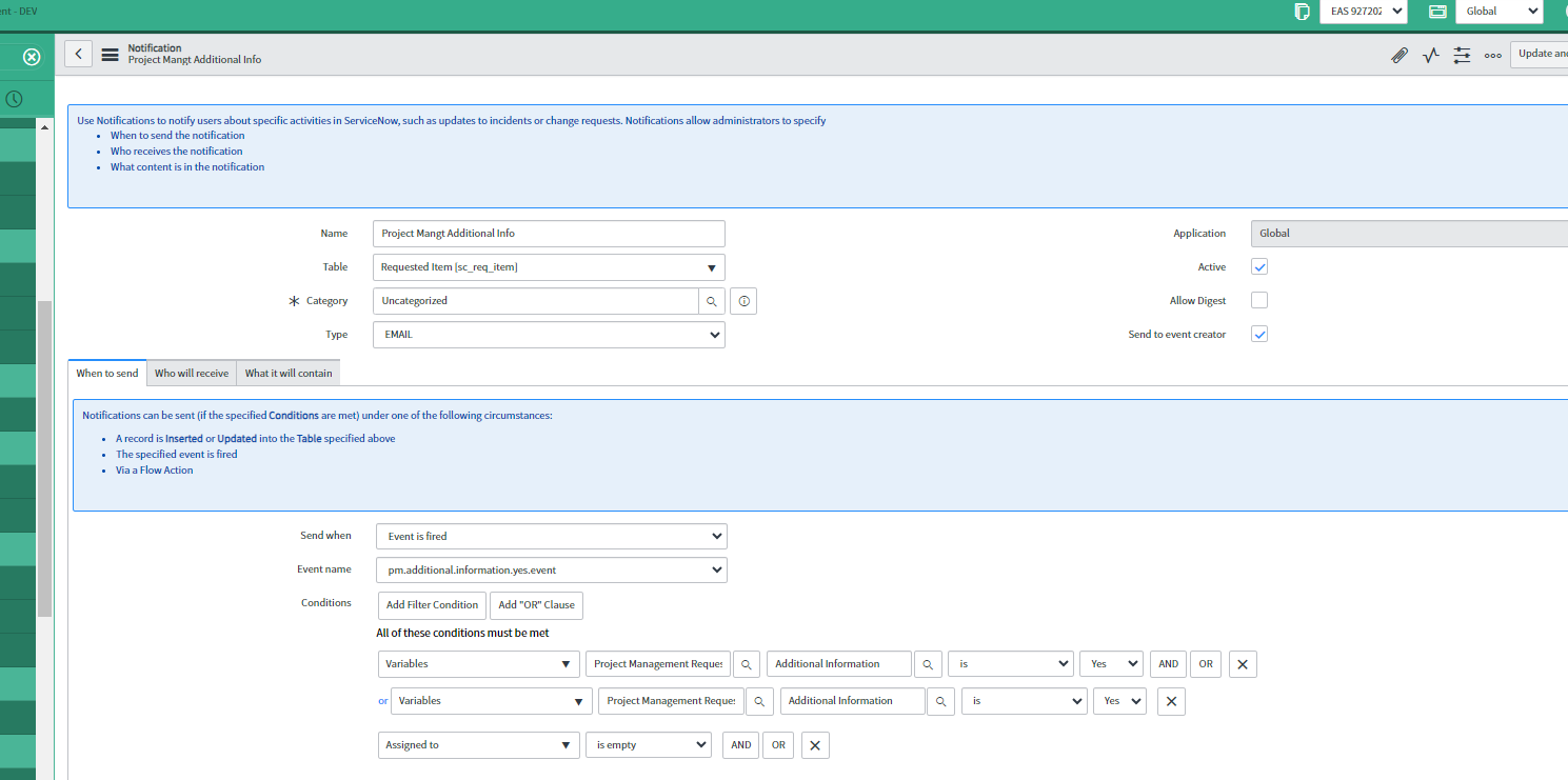

I created a notification to send if a catalog item variable is Yes - see attached details. The good news is that the notification sends when the variable "Additional Information =Yes" However, the bad news is that the notification is constantly sending when any update is made since the variable is always yes. Any suggestions how I can trigger this notification to only send one time when Additional Information changes to Yes? I verified changes to is not an option to select after the variable is selected.

Thanks so much for the feedback. I suspected I needed to do something similar to what you suggested but wasn't quite sure how. I think we are close to resolution. Unfortunately multiple emails are still being generated when the state is change, assigned to is added etc. I believe the script isn't working because additional information starts in a "no" state and should only trigger when it is changed to yes. Attached is a copy of the notification, event, br, variable. Please let me know if you have any suggestions.

Hi @Gemma4 ,
Remove all the condition in the notification
when the RITM being submitted Additional information is "No" right
in the BR script, change this
if (previous.variables.additional_information== "no" || previous.variables.additional_information== "No") { //check previous value is no
        if (current.variables.additional_information == "Yes" || current.variables.additional_information == "yes") //check if the updated value is yes
            gs.eventQueue('eventname', current, gs.getUserName()); //replace gs.getUserName() with the user you want to send email
Accept and hit Helpful if it helps.

the challenge here is , you want to trigger email during variable change not during  Field change (fields have changes in the filter condition)
i have tested this in my PDI with one of the variable , you want to make sure the variablename and gs.eventQueue logic is correct.
