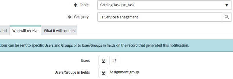

I have requirement to send the notification to all those user which are selected in list collector on catalog task.
This notification should trigger when the task is closed complete .
I have tried this sending the notification through workflow attached to catalog item
and in the notification script i used below code .but it is not sending the notification but when selected one user in To field it is sending the notification but for below code it is not working
answer = current.variables.responsible_service_managers.toString().split(',');

I totally missed you were trying to use a catalog variable. In this case you can create an async business rule on the sc_task table that triggers when the catalog task is closed complete. The business rule will then create an event for the email notification.

Hello Jwalton,
I tried above solution but I am not able to get the variable in who will receive.

ā06-16-2022 09:23 AM
I have used below script in business rule and it is working fine
var memberships = current.variables.responsible_service_managers.toString().split(",");
var serviceManagers = [];
for(var i=0; i<memberships.length; i++) {
var grMember = new GlideRecord('sys_user_grmember');
if (grMember.get(memberships[i])) {
serviceManagers.push(grMember.user.toString());
gs.eventQueue('servicemanager.email', current, gs.getUserID(), serviceManagers.toString());
})(current, previous);
