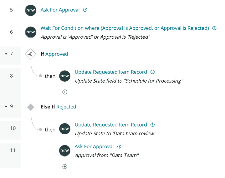

Hi @jmiskey ,
The approval field will be automatically updated to 'Approved' once all the groups approve and it'll be set to 'rejected' if any one of them rejects it, you can add a Wait for Condition after the approval action. It'll wait until the approval field is updated to 'approved' or 'rejected'. After than you can add a IF condition, please refer to the image below, i tried to replicate your requirement.
