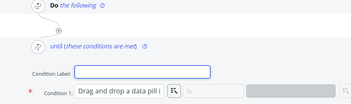

as per mu understanding the flow should be :
  • Insert a Do the following logic block into your flow. Set the condition to run as long as the approval state is Rejected or like Rerouted.
  • Inside Do the following, add the Ask for Approval action where Approval goes to the group associated with the Domain field.
  • Also add an If block checking if the approval was Rejected. Inside this If block, add a Wait for Condition action.
  • Once the team updates the domain, the Wait for Condition is satisfied. The flow hits the end of the Do While loop, goes back to the top, evaluates the new domain.
I'm still in the process of developing it. My query is how can I get the domain value from the approver after the original request is rejected in the same flow execution.
Whenever I try to update the value, it is taking the old domain's value
