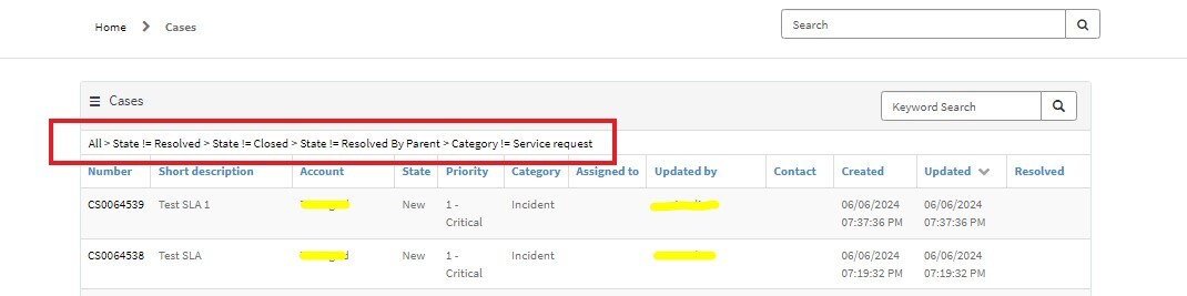

Hello gurus,
I need help with a Service Portal requirement. We have a portal with a filter that automatically pulls and filters the list based on predefined conditions.
The requirement is to:
- Add an additional condition to the filter (this part is done).
- Ensure the new condition only applies to one account, without affecting other accounts using the same portal.
( this is where i need help/ ideas or suggestions) as the service portal is being used by multiple accounts and we only need to apply the filter with additional condition to only 1 account. The challenge is that any change to the filter impacts all accounts, even when impersonating users from other accounts.
Is there a way to configure this using out-of-the-box features, or is customization unavoidable (which we prefer to avoid)?
Thanks for your suggestions.
Please see photo for reference.

Hi @jabaya ,
It is not possible to set different filters for different accounts. However, you can create two widgets and make the widget visible based on accounts.

Hello @Saloni Suthar  Thankyou for this response, if i understand correctly does this mean i can clone the widget and make it only visible to this specific account.....?
jillellaK
Yes you can do that !

Thankyou , successfully completed my requirement.
what i did is to clone the widget.
install a plugin for service portal
and set a user criteria for whoever can/cannot view the widget. Thanks !
