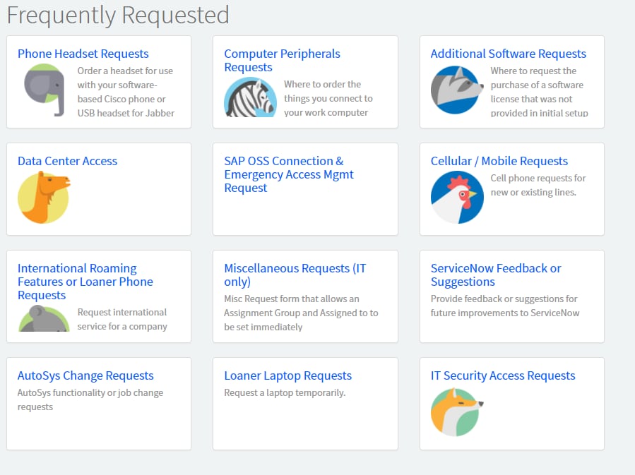

I'm trying to modify the SC Popular Items widget so it sucks less. See below for what I'm getting when I try to take advantage of pictures:
Cutoff pics depending on the length of the title.   I'm not sure what I can do to prevent this, without throwing off the entire layout.   Any advice here?

I just put that into the CSS right?   If so, it doesn't seem to be doing anything.
could you please open and check dev tools , whether css is getting applied to that element

It kind of depends what you want to happen here, do you want the pictures to become smaller and the titles to remain full, or do you want the titles to get cut off and the pics to remain the size they currently are?
A correction to The h1 element is outside the .panel, the headings we're trying to adjust are h4
.panel h4 {
        line-height: 1.2em;
        max-height: 1.2em;
        overflow: hidden;
if you want the pic to adjust smaller when the title is longer you might almost need to use some sort of javascript to get the height of the title, and size the picture accordingly. I don't think there is a way to base the size of an object off of it's containers height without javascript. (so going with the above method is probably the simplist)
