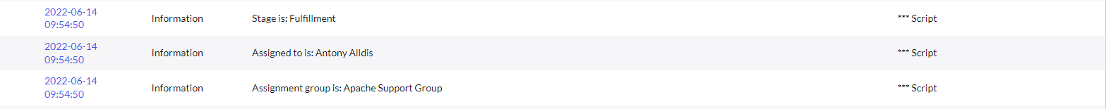

I have three variables on my Item as you can see, callled "stage_read_only", "fulfillment_group" and "assigned_to" and BR which takes current values from RITM. It takes actual values and I am able to print it to the log but not set to the variables. Dont know where the fault is.

var stage = current.stage.getDisplayValue();
current.variables.stage_read_only = stage;
gs.log('Stage is: ' + stage);
var afg = current.assignment_group.getDisplayValue();
current.variables.fulfillment_group = afg;
gs.log('Assignment group is: ' + afg);
var assignedto = current.assigned_to.getDisplayValue();
current.variables.assigned_to = assignedto;
gs.log('Assigned to is: ' + assignedto);
})(current, previous);
edit: I forgot to say that BR is after Insert / update.
