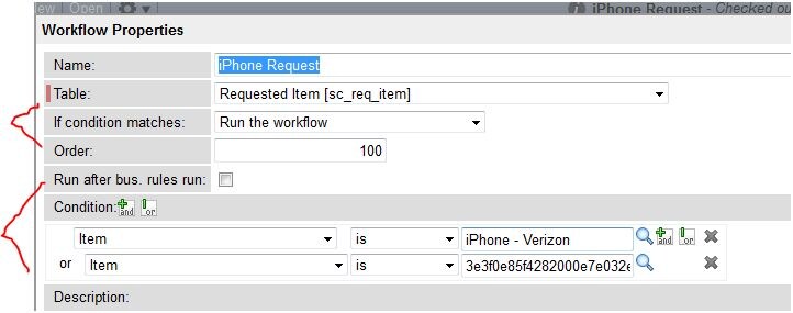

Spot on, I would like to add that there are a few ways to kick off a workflow as well.
1. A catalog item can specify which workflow to run in the "workflow" field.
2. The workflow itself has conditions that can be configured to run when its conditions are met. Check out a workflow, click the gear and select, "Properties". See attached. I bet your purchase order met a condition this way if you only ordered 1 item.
Generally you do not want to have both instantiated for the same item, otherwise you can get dual workflows running.
