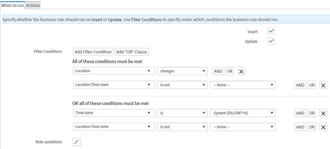

and the following as a before insert/update sys_user business rule (to account for subsequent updates) seems to be working OK.
Please let me know if you see anything out of place with either (I just added an 'Active' query to the background script) and added conditions to the BR to account for updates if a Time zone is not set that could be or when user location gets updated (and a time zone for that location is available).
Nice.  It looks like you've got some good conditions added in that business rule and your background script.  I don't see any problems with either of those.
