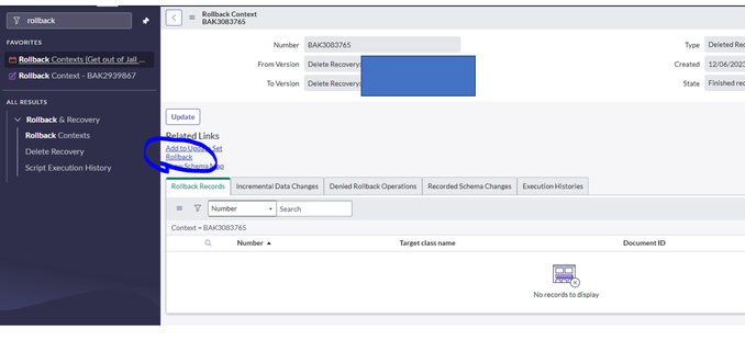

1. Using setWorkflow(false) prevents any related Business Rules from running as a result of your script. In many instances you want them to run, removing related records is one good example, in other cases you want the script to not affect anything else and you would want to use it. The best way to determine this is look at the existing Business Rule defined on the table you are manipulating and deciding if you want those to run or not depending on your desired outcome.
2. Yes your script may well lead to orphaned records. Finding them would be very difficult depending on the amount of data the script changed  after the result. If you ran this as a background script look under Rollback and Recovery > Rollback Contexts in your menu (as an admin). Find the record where you ran the script and open it. Under the Related links there is a 'Rollback' option, using you would be able to roll back the results of the script then take out the setWorkflow(false) and run the script again to prevent orphaning.
