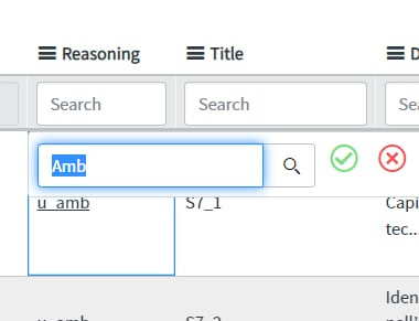

i have two tables:
1) target table with a reference field
2) source table referenced to target table. In this table the DISPLAY attribute is set to choice field.
When i insert data in the table 1 i see that the reference field shows the value of the choice field referenced. But i want to shows the related label. How i can set the source table (and in particular the choice field) in order to see label?

Hi Daniel,
Check if ref_ac_display value for the dictionary entry of Reasoning field is set to 'false'. If yes then remove this attribute .
i've removed this dictionary attribute but it appears the value of the field again and not the display value.
This change should involve the field showed in the row because the field that i see when i double-click on the field is correct. Please, see the attachment.
Thanks in advance
RESOLVED:
In the table Target I have shows in the List Layout not the Reasoning field but the Reasoning.Name field.
