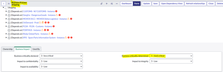

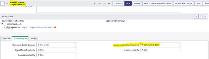

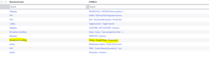

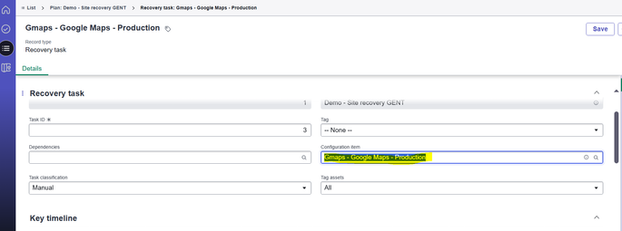

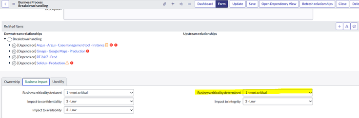

Suppose this configuration item is attached in the recovery task then we should go to cmdb_m2m_business_process_ci table and try to find the configuration item attached with the business process.
Now that business process contains a field which decides the criticality. If 1-most critical then the recovery task should be placed at the top of the list.
Now this "Breakdown handling" business process contains the field which decides the criticality.
Once we get the information then the recovery task should be placed at the top.
If there are multiple business process having the same criticality then sort of recovery task to be done in alphabetical order.

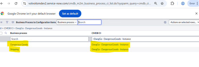

There might be a case where one configuration item can have two different business process. One of the business process criticality is 1-most critical and the other is 2-somewhat critical. Still it should sort considering the recovery task as 1-most critical

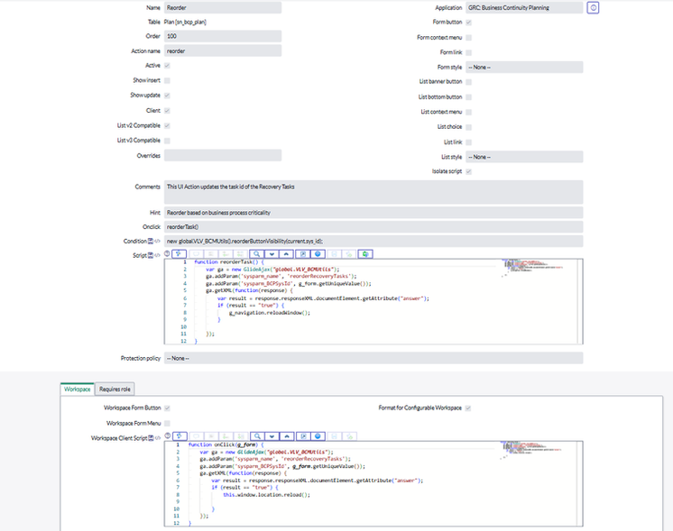

1. Create a UI Action: Reorder.
    Configure this for both Native UI as well as Business Continuity Workspace.
    Refer to screenshot below for UI Action:
UI Action code for Native UI:

UI Action code for Business Continuity Workspace:

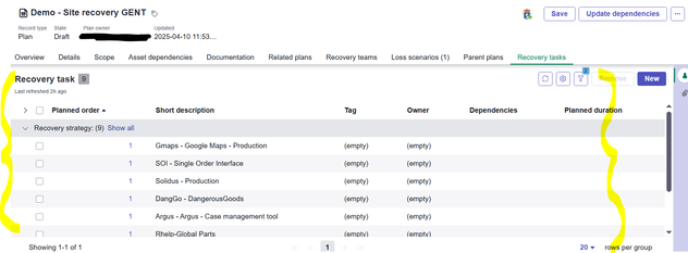

The recovery tasks before clicking the Reorder Button:
      > Verify the Task ID

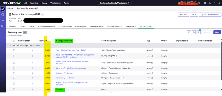

The recovery tasks after clicking the Reorder Button:
As there was multiple recovery tasks with criticality 1 so task id was updated as 1010,1020...
For criticality 2, the task id was updated as 2010,2020....
This continues till criticality 4.
There were few recovery tasks which didn't had a configuration item attached then those were updated as 5010,5020....
