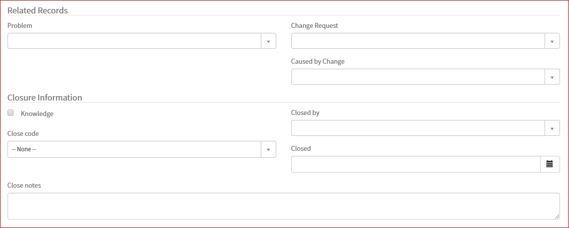

How to display Form sections of service portal  in tabbed forms just like ITIL view. Current it is displaying one below one.
This property is also checked
