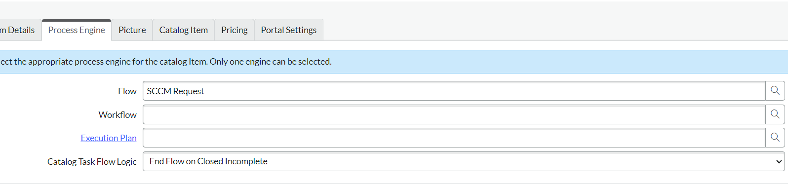

I am having a Request item where there are multiple tasks in catalog task definitions. I have used flow designer to trigger task based on the conditions. This is working fine when the tasks are closed complete. But when I mark the task as 'Closed Incomplete', the request is also marked as 'Closed incomplete' but even after that a second task is being created. This happens very inconsistently and I am not sure how to resolve this issue. I have already set the catalog task flow logic as 'End flow on Closed Incomplete'. Please guide me on the solution

Hi @Hemanth M
Yes. We have this flow logic set as 'End flow on Closed Incomplete'. Other than this I see one BR on sc_req_item as below, but I am not sure if this will be reason for my issue
