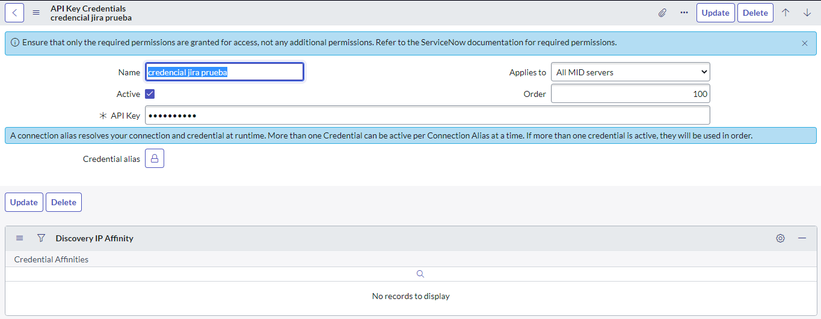

1.) Create a credential:  Here I did a different step than in the video since the token was very long and it wouldn't let me create a "Basic auth" credential so I created an "Api key"

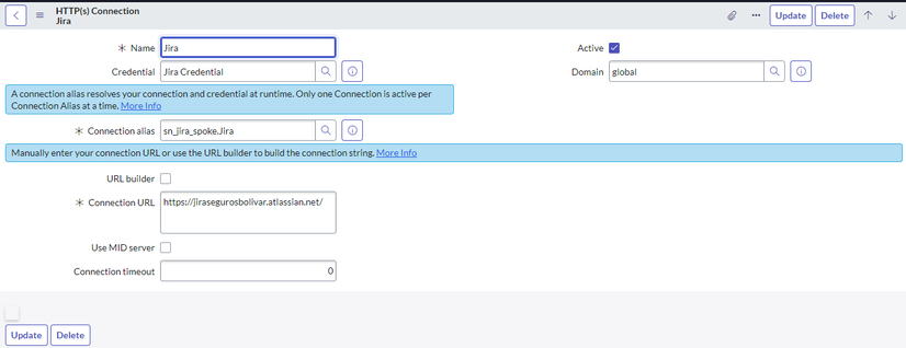

2.)Create a connection: here i did exactly the same as the video

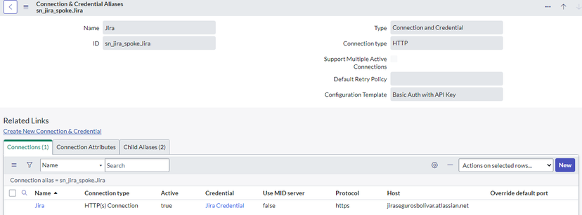

3. Here i checked "Connection & Credential Aliases" in Integration hub:

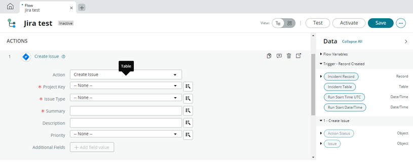

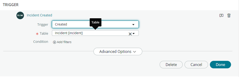

4.) In flow designer, i created a trigger:
5.) Finally I am ready to create an action: action-Jira-create a issue.
This is where it should show the "connection alias" field but it doesn't.
Thank you for your help.

This is expected in the new versions of the spoke see the documentation Jira Spoke (servicenow.com)
  • Some of the spoke actions from this release onwards don't have the Connection Alias input.
    The existing flows in your instance that use actions of the previous versions, continue to work. However, those earlier actions are renamed by adding the deprecated suffix and you can't use them from this version onwards.
This spoke uses the Jira alias record. To use these actions, you must create a connection record and a credential record and associate them with the Jira alias record.
In Workflow studio view the "Integrations" and search for jira. You will see the record for the sn_jira_spoke connection alias.
Configure this connection and the spoke actions will use it automatically
