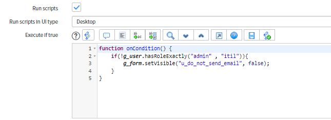

In our instance, we had a previous contractor input a field and have it show up based on role, but the problem is that it shows up only for admins, and we would like it to show up for 3 specific groups as well.
Here is their code:

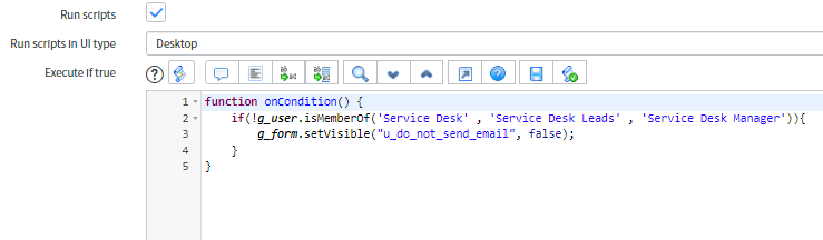

This code seems to make it so that only users that have both ITIL and the admin role can see the field. All others can't see this field. I tried doing this to change it, but I think my issue is that I don't know how to make it read "if user is in these groups, then show the field". Here's my code massaging below:
I'm not sure, but I feel that the argument in Line 2 is an AND operator (like they need to be members of all these groups for it to show up), but either way, I can't seem to get my field to disappear now no matter what group the users are.
Can someone help me with my script to make it so that those 3 groups in my code are the only ones who see the Do Not Send Email field I have on the Incident form?

08-09-2022 09:54 AM
Hello you need to check like this by separating it
If(gs.getUser().isMemberOf('your group name') ||gs.getUser().isMemberOf('your group name'))
//set visible
same goes with roles also separate them into two using has role exactly
Mark my answer correct if it helps you

08-18-2022 04:53 PM
I appreciate the help from both of you.
Aman, I'm not sure that I want to create any Business Rules that I would have to deal with later, I'm better sticking with just the UI Policy that was created by an outside contractor and editing it to actually do what we asked them instead of it being broken. Should I need to create business rules in the future, I will be referring to your answer though, I appreciate it.
Mohith, my JavaScript knowledge isn't super, so would you be able to explain to me the difference in using g_user.XXX() versus the gs.getUser().XXX() notations to call a user? for example, why wouldn't I be able to just say this:
if(!g_user.isMemberOf('Service Desk') || !g_user.isMemberOf('Service Desk Leads') || !g_user.isMemberOf('Service Desk Manager')
instead of
If(gs.getUser().isMemberOf('Service Desk') || gs.getUser().isMemberOf('Service Desk Leads'))
I'm just not clear on the differences so I don't know if your answer helps me yet. Thank you for any clarification you can give
