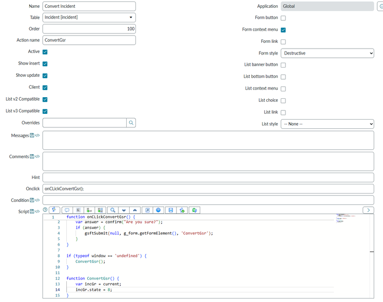

I might have the most stupid question, which I hope you can explain the reason. I'm trying to create a Client callable UI action with both client side and server side code in it.  The setup is like this:
Where the code written is (currently just some test code):
function onCLickConvertGsr() {
    var answer = confirm("Are you sure?");
    if (answer) {
        gsftSubmit(null, g_form.getFormElement(), 'ConvertGsr');
if (typeof window == 'undefined') {
    ConvertGsr();
function ConvertGsr() {
    var incGr = current;
	incGr.state = 8;

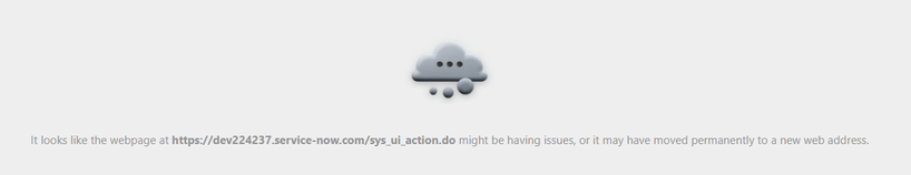

When trying to save this i get this error:
Can one of you explain the reason for this?

@AndersBGS
did you try creating fresh UI action?
Also you can directly assign the value using current and you forgot to update
Ensure no before update BR stops the form submission
	current.state = 8;
        current.update();

Dear Andres,  The possible reasons You are seeing the error page because:
  • /< gsftSubmit() invokes server execution
  • Server-side logic is incomplete (update() missing)
  • Minor JS naming/case issues
  • Mixed client/server code not cleanly separated
Fix:
  • Use proper typeof window === 'undefined'
  • Update the record explicitly
  • Keep the script minimal and platform-standard  />
The attached script is the revised version has the fix:
  • Properly separates client and server execution
  • Avoids function nesting issues
  • Uses the standard  </gsftSubmit() /> pattern
  • Fixes the error you are seeing in the snapshot
  • Java script is case sensitive CLick instead Click
