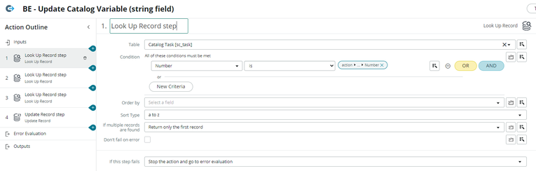

2. Create a lookup to the task record number

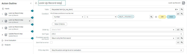

3. Create a lookup to the request item number

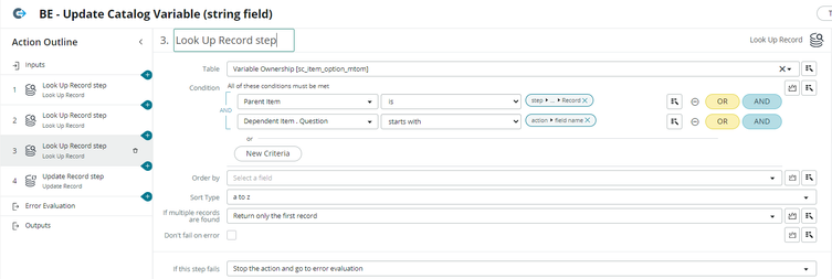

4. Create a lookup to the variable
Put the request item in the parent item an the 'field name' variable in the 'Dependent item.question
5. Update the value of the dependent item with your variable.
