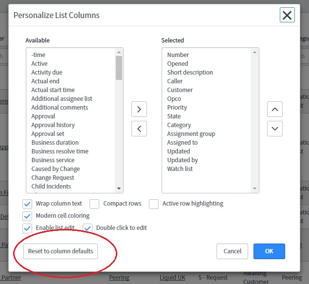

‎02-01-2018 01:50 AM
If it's a list view and you have added in the columns that you want make sure they haven't personalised the columns they want to see.
If you click the gear icon and see 'Reset to column defaults' that means they have personalised their list view which will override what you have configured. Reset to default and they should see the new layout you've made.
