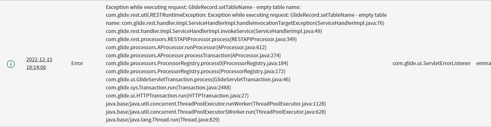

Also I've attached the error message system log that is generated when I try to move a card impersonating that user in question. But nothing is logged when I try to do it as an admin because the card moves without problem.
