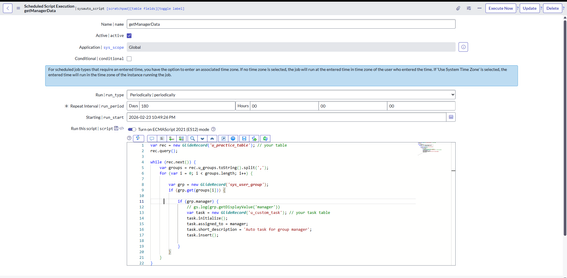

in custom table with list field group refer to group table.
i want create some custom task using sheduled job.
scheduled job run every 6 months.
department field contain multiple values
eg: Group1,group2,group3.
newly created task assign to needs to be corresponding department (group) manager.
example:
1 . record have 2 groups.
then task needs to create for to managers while runing the job.

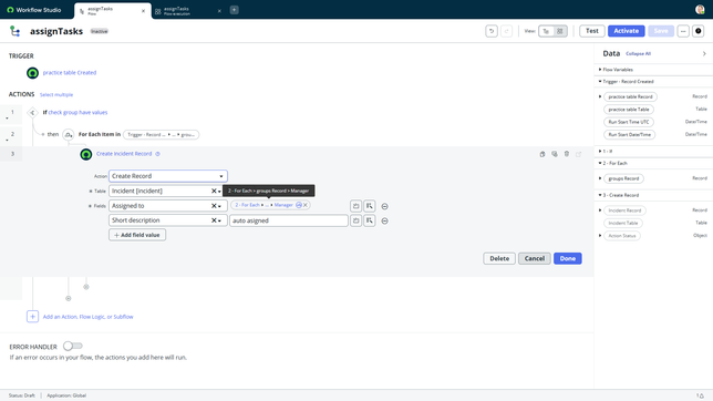

Hello @armanoj ,
As per your previous question schedule job which run every six months below code will works :
And as per latest requirnment with flow will work :

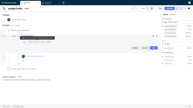

First check grp field has values or not then if yes iterate for each loop on groups field .
In your case you need to iterate on department field and then create new record and assigned it to group manager.
If this helps you then mark it as helpful and accept as solution.

Hello @armanoj ,
By above flow its creating two tasks(here i created 2 incidents) and assigned to group managers. For this i iterate for each loop on groups field( in your case its department).
