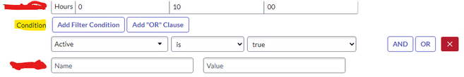

Hi all,
we have created one ATF scenario while doing that in a table there is one condition field it's type also condition. Using set field value step not able to set it. Can you please help me on this. is there any step to do it.
