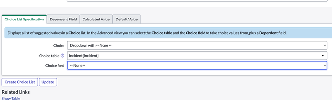

Hello @felixmiske ,
Configure dictionary on the choice field,
In the related links, click Advance view
Select the Table and choice from where you want to have a replica.
Here, the choices on the Problem will be show the choices of the Incident table.
If the above information helps you, Kindly mark it as Helpful and Accept the solution.
Najmuddin.
Yes, it is possible:
  1. create Choice field for table A and add relevant choices
  2. create Choice field for table B
    1. Related Links > Advanced view
    2. tab Choice List Specification
      1. Choice table: table A
      2. Choice field: field created in the first step for table A
ServiceNow documentation: View choice list definitions
