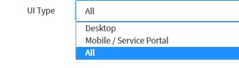

How are you populating the data in those other two fields? Through Client Script or something?
If so, check that the client script is set to run in both or all environments, instead of just having it selected as portal:
