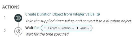

Jeffrey-Ian Ric
Mega Contributor
Very nice solution!
I had been looking to do something similar, but I wanted the timeframe to be a little more flexible, so that other internal developers would be able to use it too.
So, the script code in my action called Create Duration Object from Integer Value is as follows:
  var timer_wait_value = inputs.timer_wait_value;
  var duration_set = 60000 * timer_wait_value;
  var dur = new GlideDuration(duration_set);
  outputs.duration = dur;
})(inputs, outputs);
 So I accept the input in minutes, and convert it to a duration and then return the duration to be used in the subflow.
Makes for a nice easy solution, I just wish they had included it out of the box!
