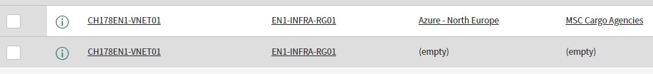

Yes, it's not updating and creating a duplicates.
it means your query is not working fine

And not all records having duplicates, but not getting updated, example as below
