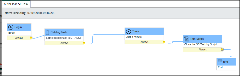

Here are some more details about what I replayed in my PDI:

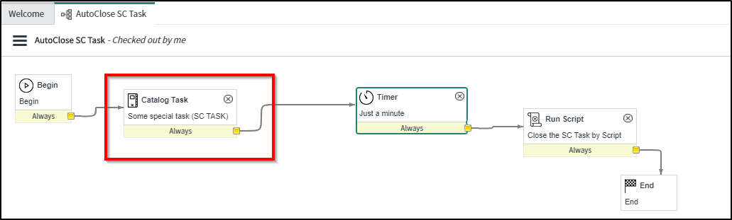

I just put the Catalog Task in sequence with the timer like shown in the screenshot above.
I used the Script 1:1 like you submitted - which by the way works perfect 🙂 Well done!
If I execute the Workflow, it creates the Catalog Task, and will immediately proceed with the timer.
At this moment, the Catalog Task is in State "Open".
As soon as the Timer runs out, the Run Script will set exactly THAT Catalog Task to "Closed Complete" (see screenshot below):
The executed Workflow looks like shown below:
The Catalog Task Workflow Activity looks like shown below:
Remember to deselect the "Wait for completion" checkbox, to make the Workflow Activity transition to the Timer immeditately.
This, I guess, is your expected behavior, right?

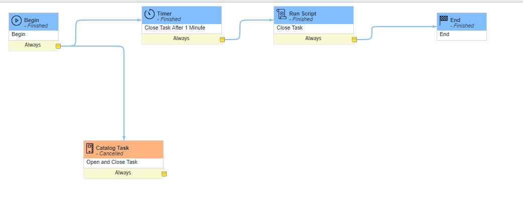

09-06-2020 12:53 PM
Can you share the script from run script activity where you are closing the task? Make sure to use the value of closed complete in the script.
Also, connect your catalog task activity to the end activity. That might also be leading it to incomplete status.
Sharjeel
09-06-2020 06:20 PM
Thanks for your response. I made change to workflow as per your suggestion but it didn't worked.
var grTask = new GlideRecord('sc_task');
grTask.addQuery('request_item',current.sys_id); // request_item is RITM reference column in sc_talk table;
gs.log('request_item='+current.sys_id);
grTask.addQuery('active' , true); // check if task is still open
grTask.query(); //execute the query
// check if result set has some task record
if(grTask.next()){
grTask.state = '3' ; // 3 is choice value for close complete
grTask.comments ='Task closed by 5minute timer';
grTask.update();
